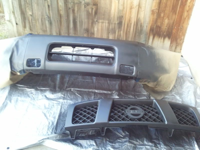

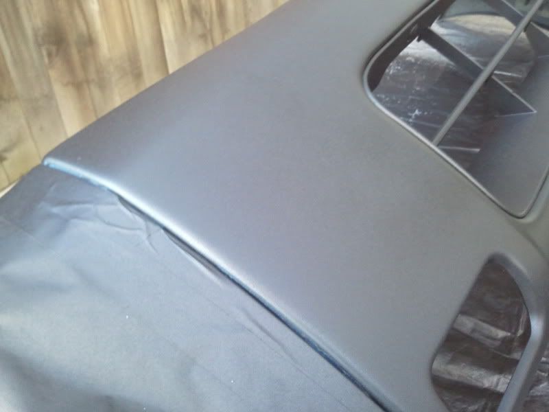

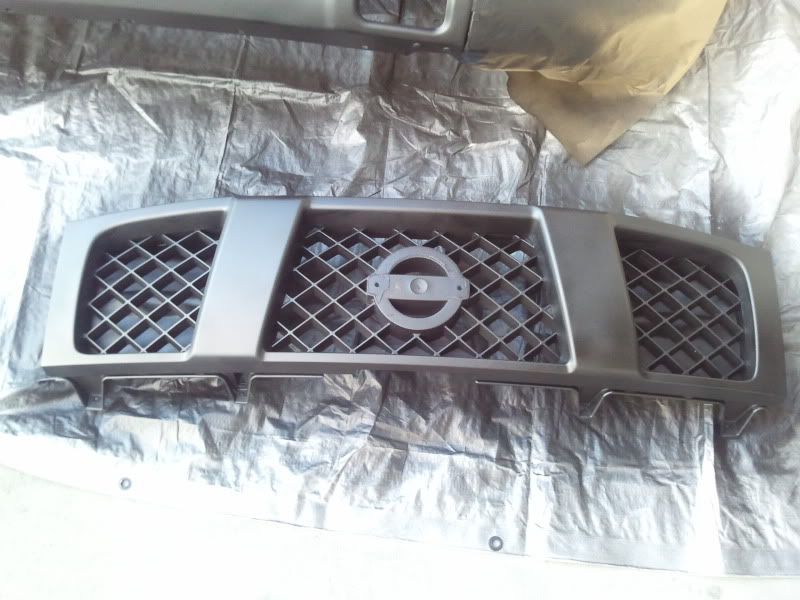

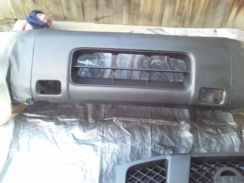

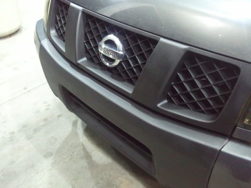

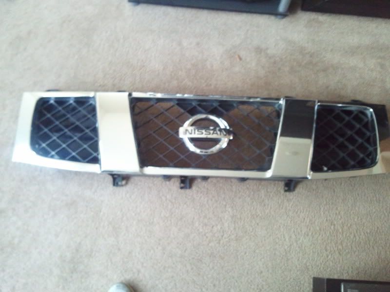

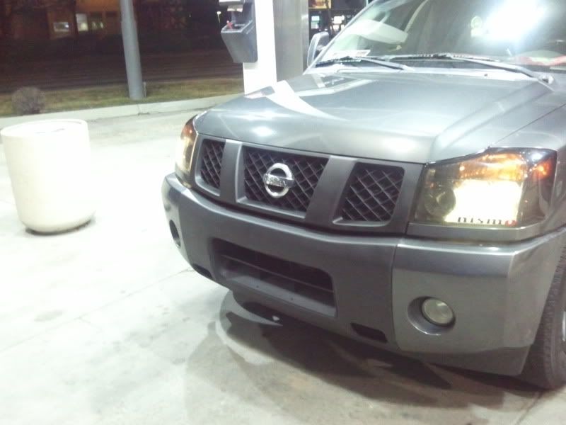

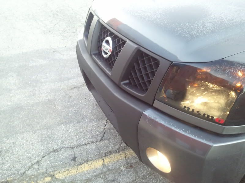

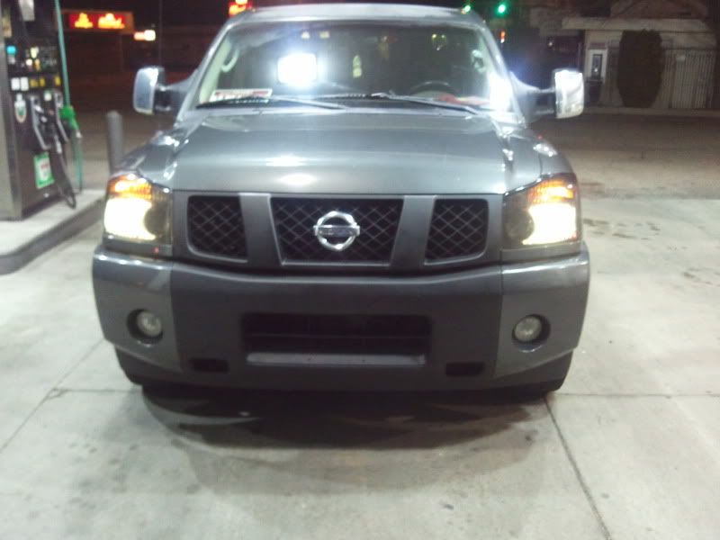

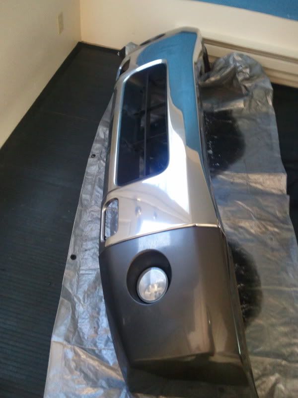

I realized the sun was actually out in Boise yesterday and the temp was abt 40 so i was like hmmm this is odd...it might be the best weather imm gonna see till march so i went ahead and bedlined my front grille and bumper. the Chrome was driving me crazy :ftard: I was a bit worried because of the temp but it turned out A-ok...went ahead and but an Aridam from an 05 Armada also as i had the bumper off anywayz.....Took all of abt 8hrs from start to Finnish including drying time and Putting the bumper back on.
Bumper off
Grille Off
Front Gone
Bumper Taped Off
Both Bumper & Grille BEdlined 3 coats each
05 Armada Airdam installed
\_\_\_FINISHED :redblob" PRODUCT_/_/_/​

That is my next mod!!!!! What did you scuff the chrome with and what brand of bedliner did you use? I have been using the Dupli-Color brand with great results. Looks really great......nice job.

Ive used rust-o-leum truck bed coating (bedliner) on my wheels and on the bumper and it dries super fast and cost abt $7.50 @ Home depot. For sanding i just used some 3m 60 grit sand paper and hand sanded it scuffing it up a bit till teh chrome gets nice and dull then cleaned it with some acetone and went to wrk with the bedliner.
