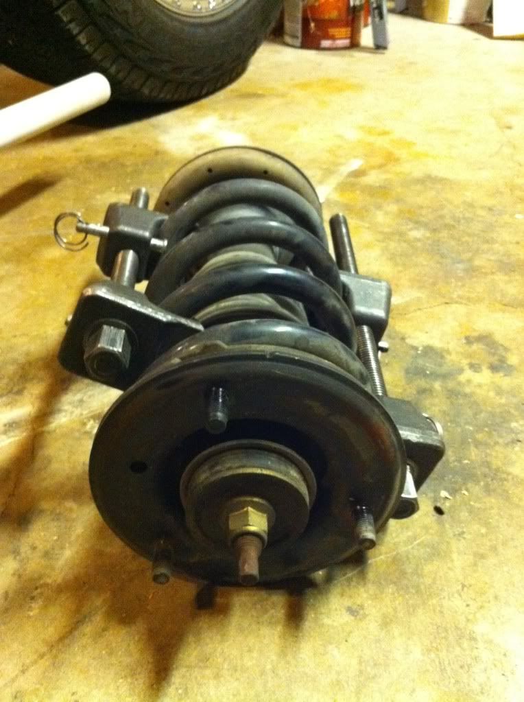

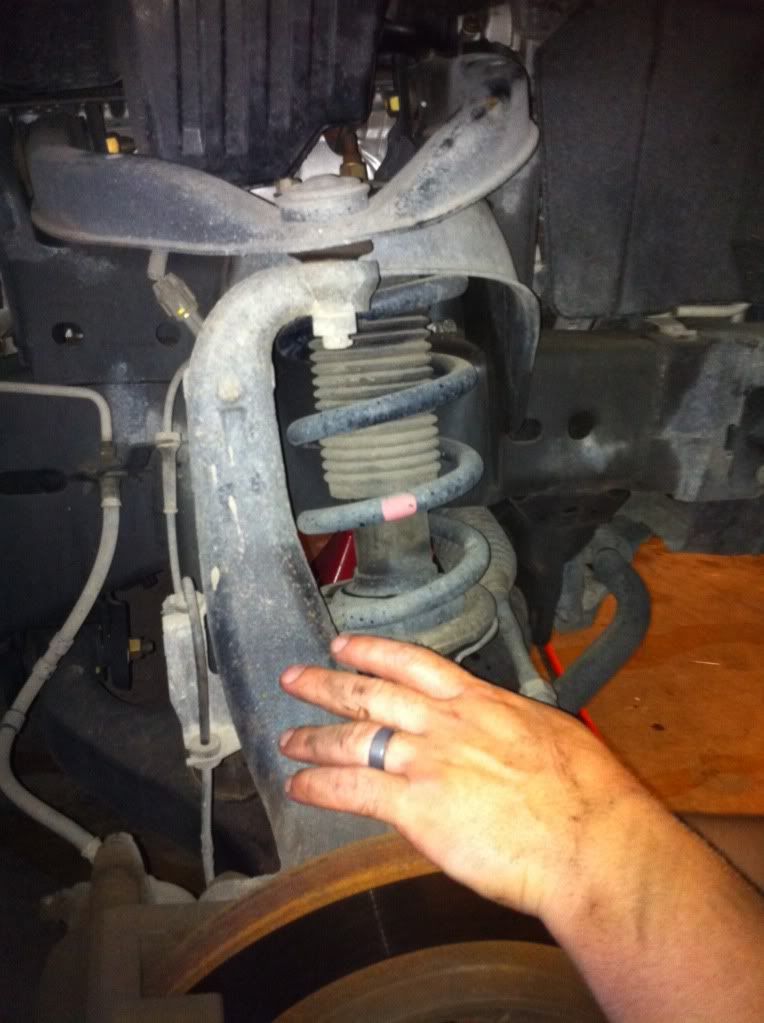

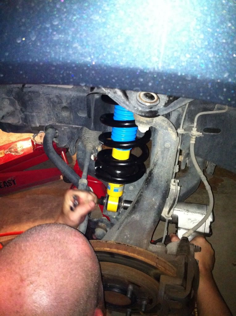

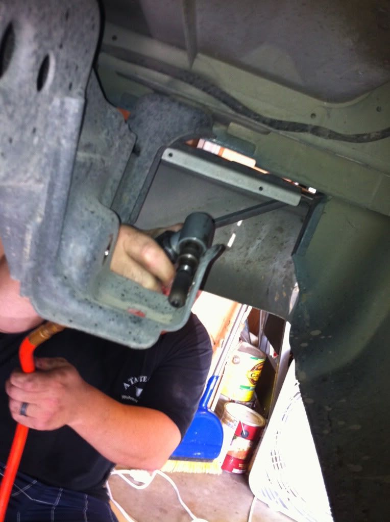

Here's the front done, took maybe an hour last tonight (or two, I was drinking)
Btw, I didn't need the spring compressor putting the new spring on the new strut - put my weight on it and got 3-4 threads ;)

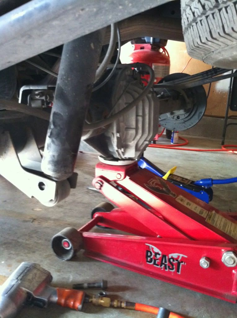

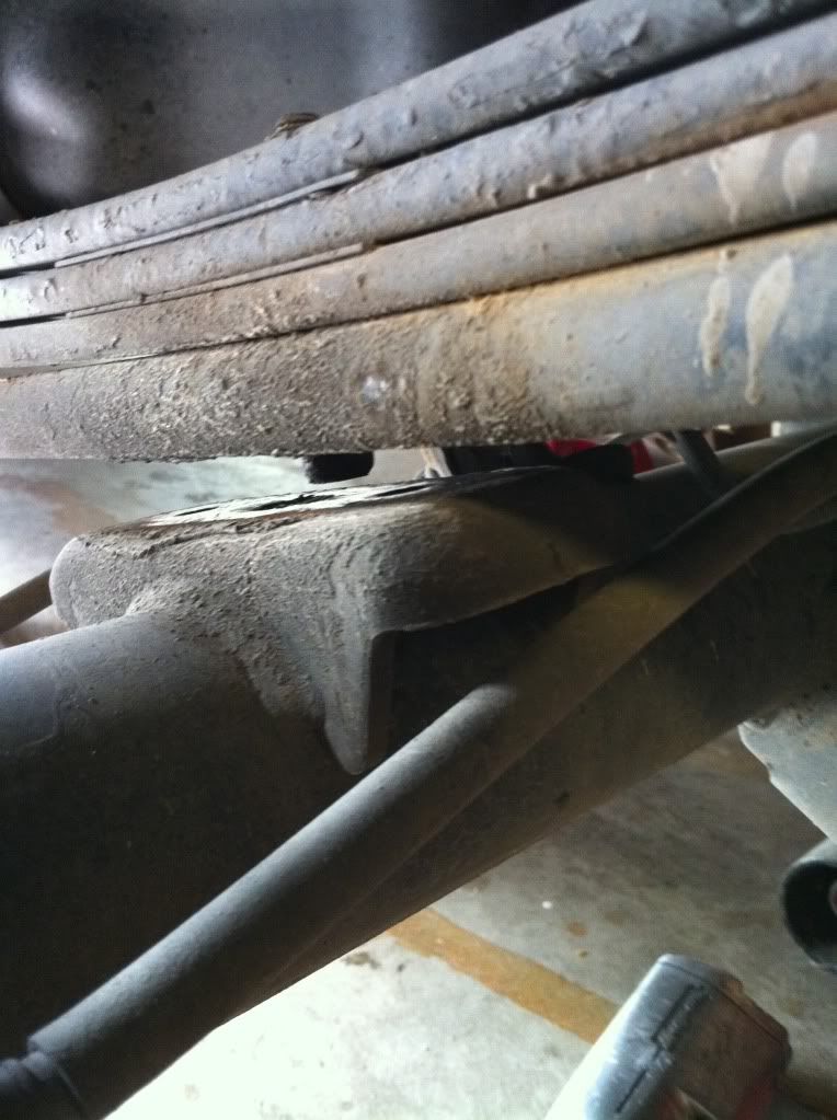

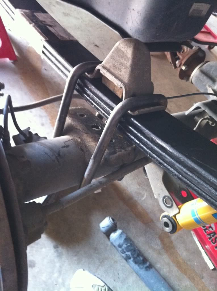

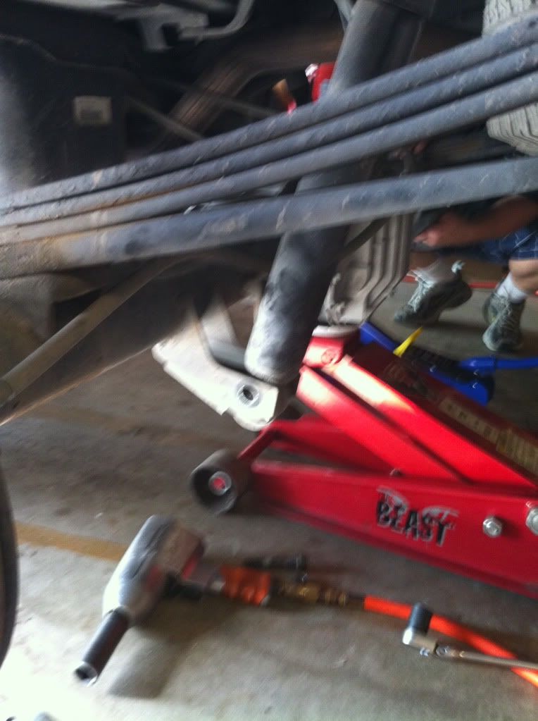

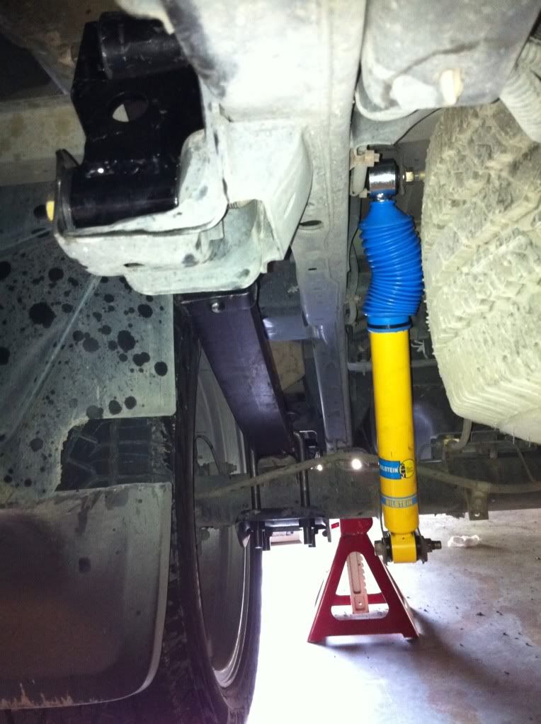

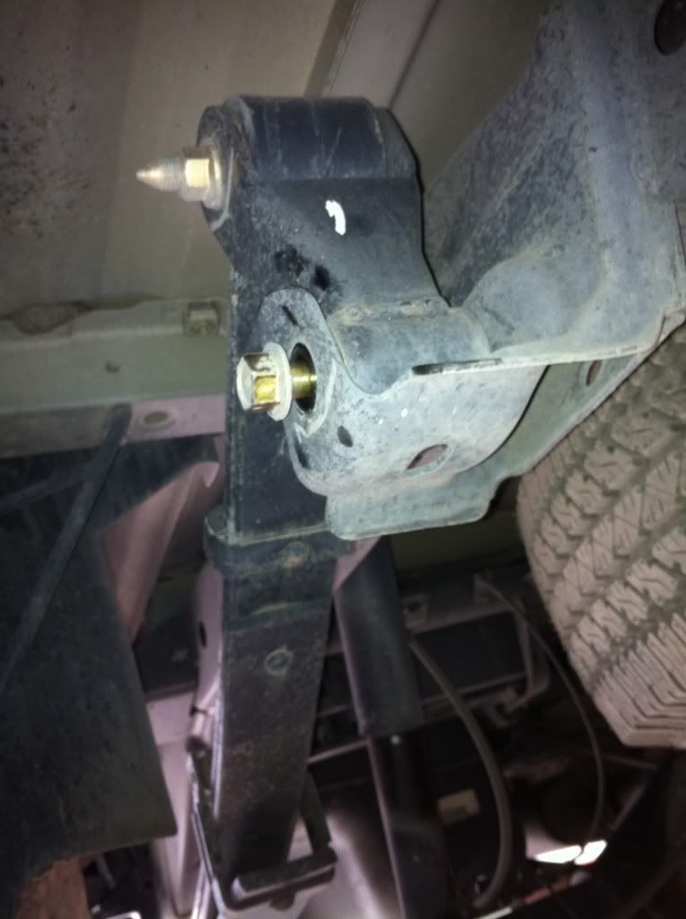

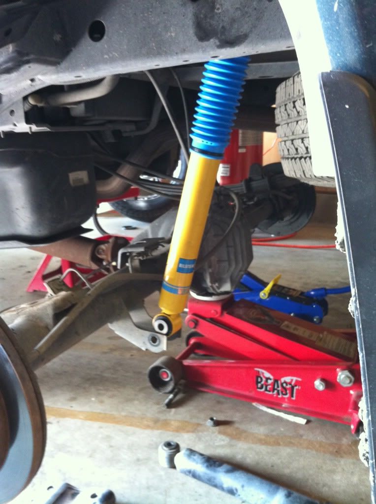

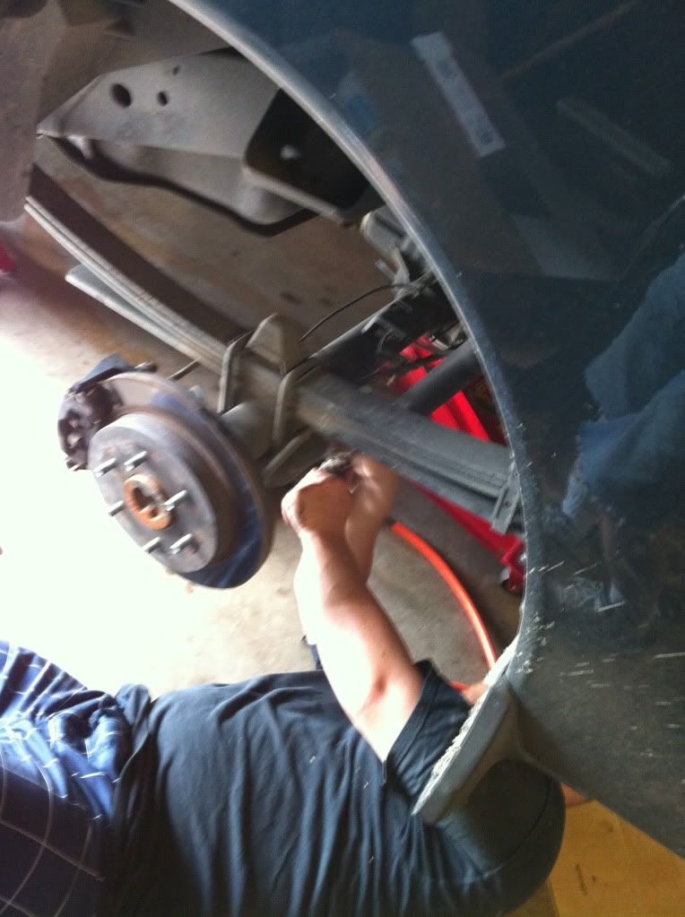

Here's the back install! Took about 3 hours today.
So about 5 hours total for front and back(drinking, eating, breaks)

Looks good..Nice job with the pics....are the new rear shocks stock length? I did remove a leaf and need new shocks...
637 Posts
Thanks!
Yes, shocks are stock length.
Only reason I replaced them was because I had stocks with 80k miles ;)
But shouldn't they be shorter for optimal shock performance? I not a shock expert just need new shocks and was looking for advice...
33 Posts
Discussion Starter · #5 ·

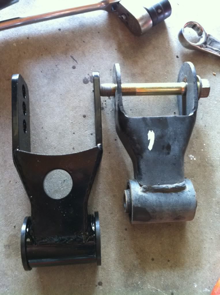

Some have said that the Bilstein HDs shocks are too long on a dropped rear end, but I didn't see a problem with them. Besides I know a dozen or so Titans running the exact same setup for years with no problems. Only noticeable con to this project was that I have more wheel hop caused by the axel wrap and that’s going to happen as long as I have leaf springs. I plan to get some traction bars to keep it put, but in the mean time it doesn't affect my daily driving.

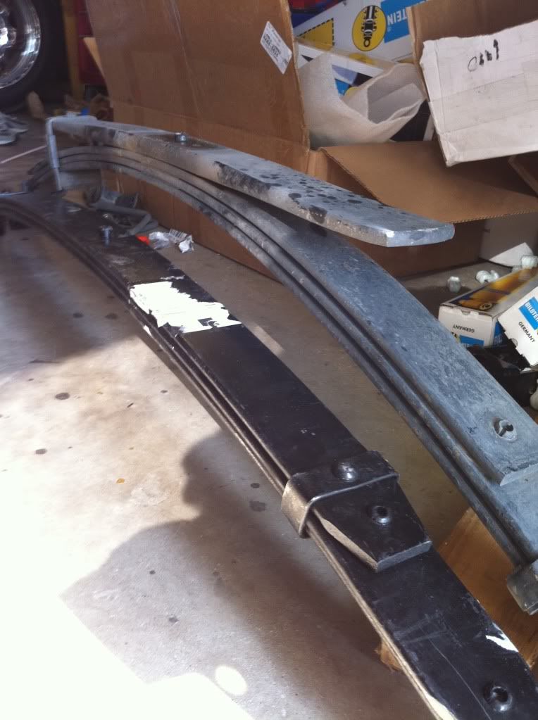

i took the very bottom overload leaf out of my stock leafpack and put it into the new 3" drop leafs to maintain my load capacity and it also doesnt let me get axle wrap or wheel hop. you might want to try that first before you spend loot on traction bars.

Smoked, yeah I considered doing that with the overload leaf when I was doing the install, but had axel wrap before, just not as bad. So traction bars may be the best option for me at this point. However, do me a favor and take a picture of the drop leaf pack with the stock overload in it.

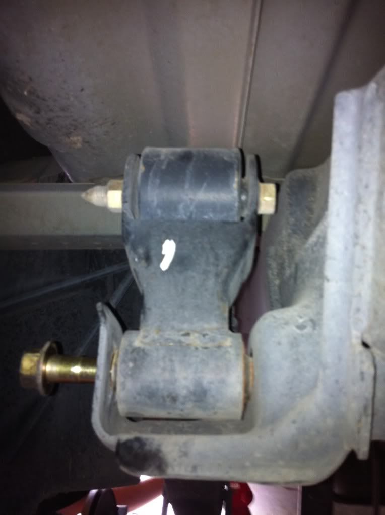

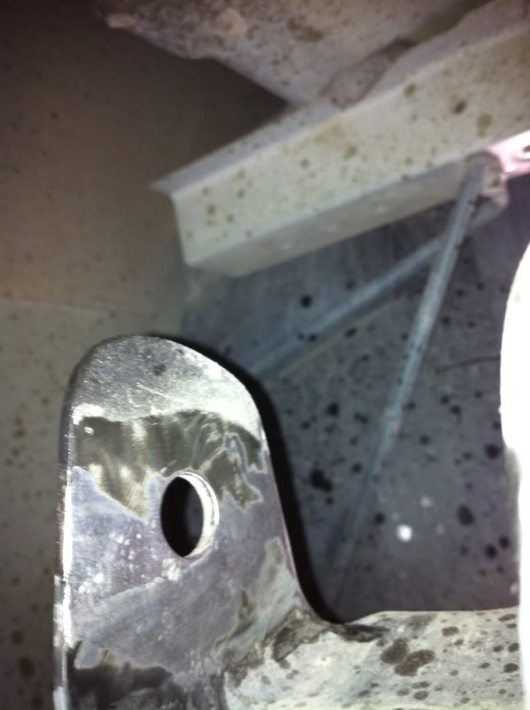

What all did i see pics of you grinding and cutting? I know alot of folks cut the tabs off when they do the PRG shackle install, but I didnt and have had no issues.
Secondly....I have the PRG street traction bars on my truck before I did the drop, and with the supplied brackets the traction bars hit the frame sometimes on big bumps. I installed my traction bars before the drop, so maybe if they were done after the drop the position of the bracket you weld would be different and ride optimal.
On your shackles you prolly need to put them on the highest setting to get the perfect look. I tried all 3 settings until i got on the last and highest which gave me a perfect height.
Secondly....I have the PRG street traction bars on my truck before I did the drop, and with the supplied brackets the traction bars hit the frame sometimes on big bumps. I installed my traction bars before te drop, so maybe if they were done after the drop the position of the bracket you weld would be different and ride optimal.

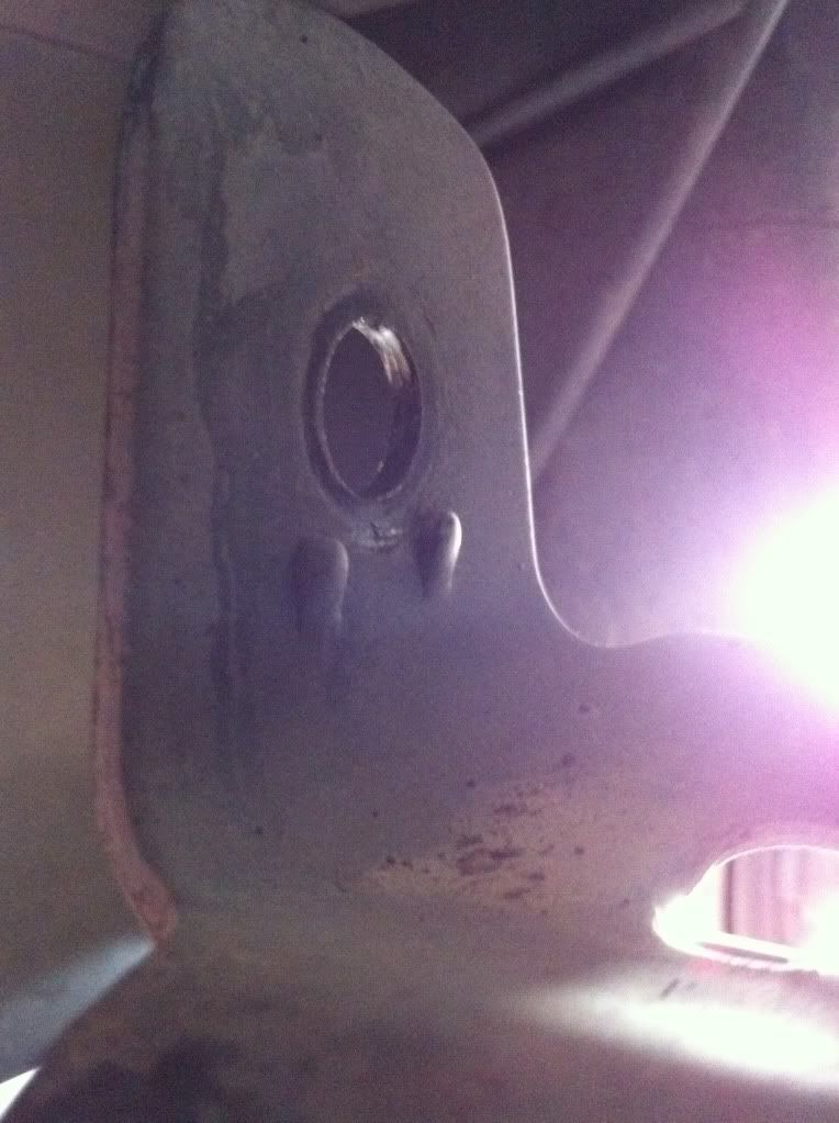

Yeah, I grinded the tabs off - they will destroy the bushings otherwise. There's a few threads showing the aftermath by not grinding these off so I didn't take any chances.
My PRG shackles are on the highest hole, which is the lowest setting. The front is starting to level out now, so no worries.
