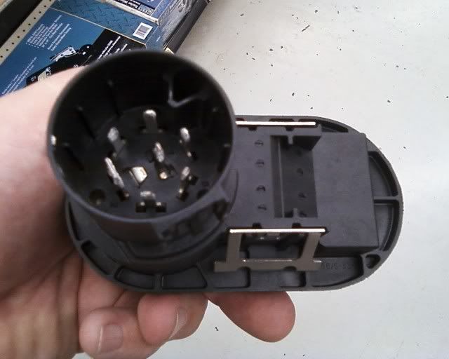

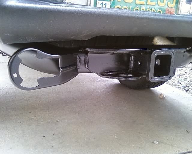

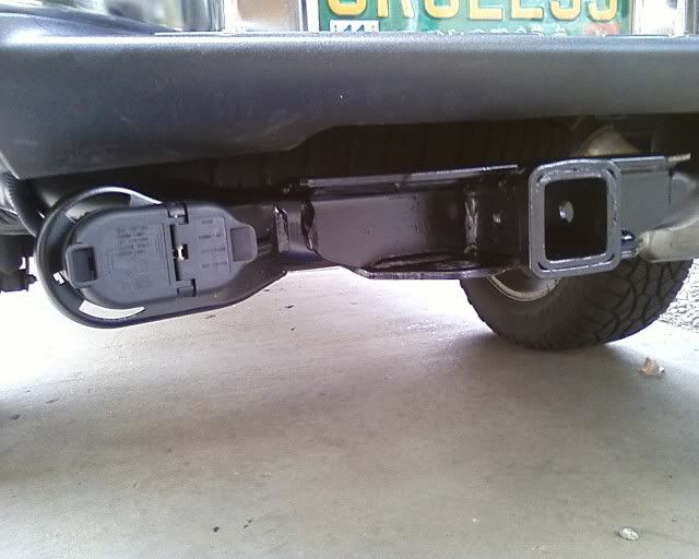

I also modified my 7-pin plug a bit. I removed the old connector and installed an new 7-pin/4-pin combo plug. I altered the stock bracket a bit, but it fits nice and works great! Let summer begin!

That all looks really nice. Very clean.
Did the OEM Harness plug right onto the new assembly? What brand/part number is the new 7/4 combo? I could use something like that.

Hopkins Part# 40975
http://www.etrailer.com/p-HM40975.html
Was very easy to do the install! Just cut your existing bracket to fit the new square plug (Or use the enclosed beacket) and plug it in! Plugs right into the factory plug. Very clean install!
