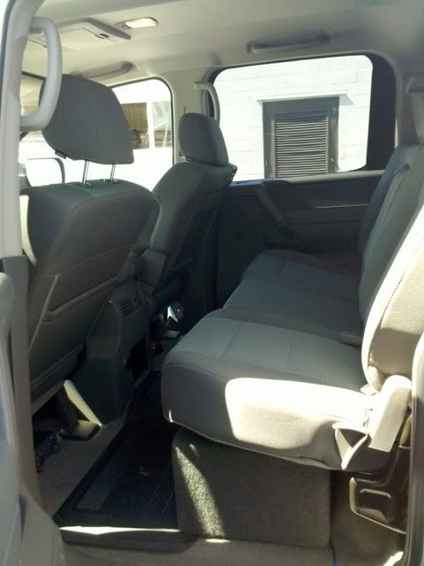

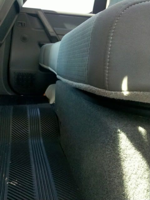

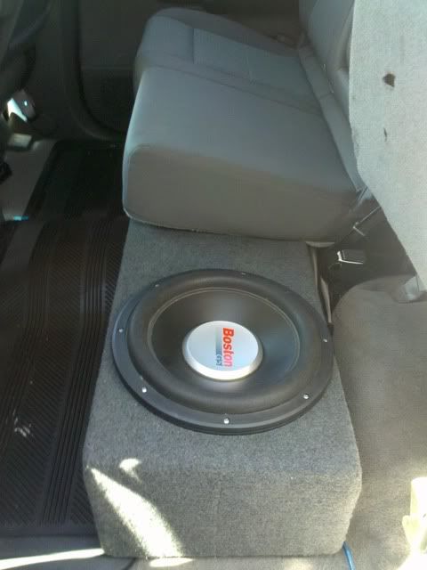

I had this sub, a Boston Acoustics G512-44, from a previous vehicle. After seeing how nobody had attempted this setup, I figured I would give it a try. After a 2" seat raise and some "massaging" of the seats underside, Tech12 was able to build a box to accommodate the subs large mounting depth and still fit under the CC rear seat. The sub is powered by a Diamond Audio D3 600.1 Monoblock amp. Its wired in a 2Ohm configuration and is crossed at 100hz. The front stage is (2) 6.5" ID-OEM Woofers in the doors and (2) Full-Range 3" Fountek FR89EX's in the dash; powered by a Diamond Audio D3 500.4 amp. Finally its all processed through an Eclipse CD8443 HU.
Pics:
Between the quality drivers and the awesome capabilities of the head-unit, this is by far the best sounding sytem I've built in a long time. The sub hits hard and in sync, not boomy at all. Thanks for looking and comments and criticism are always welcome!
